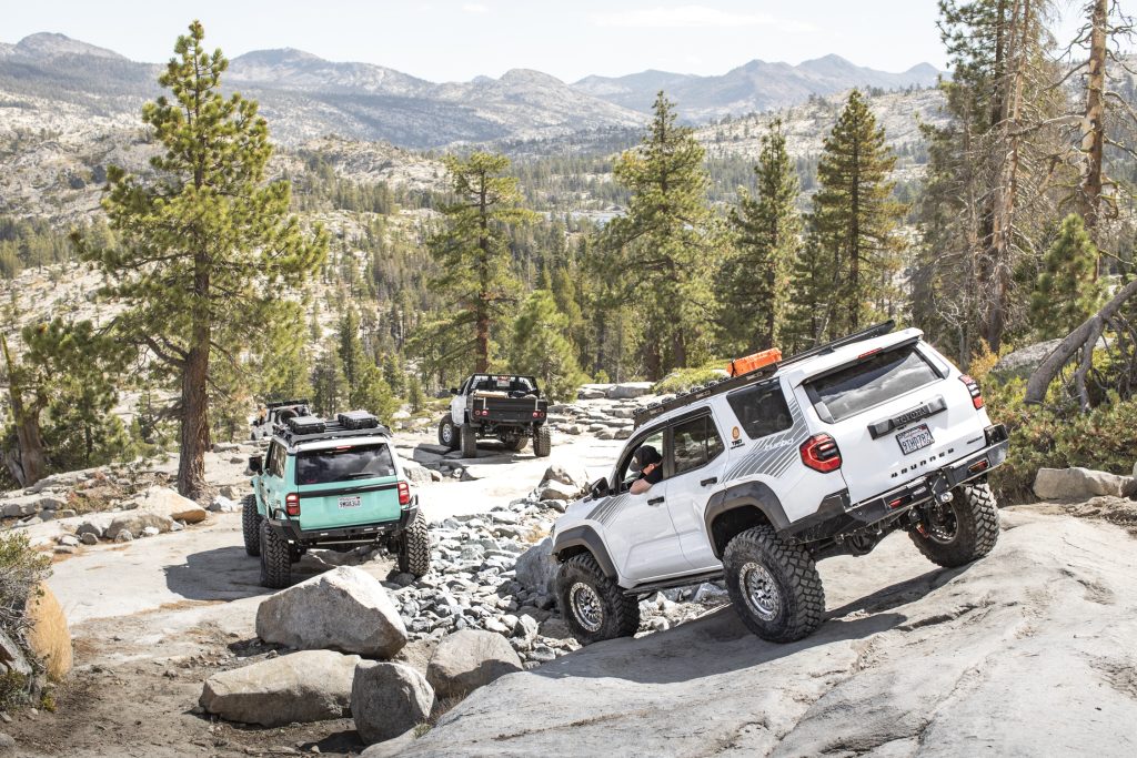

We started at Loon Lake and wheeled into Buck Island, camped for the night, and then camped again at Rubicon Springs the following night. A few of the guys we were out with have never been to the Rubicon, so we took our time and showed them around. Although we completed the trail in three days, we could have easily completed the trail in 1-2 days. This is my 6th time wheeling the Rubicon, so I have plenty of experience with navigating the trail.
I also have a 5th Gen 4Runner on portals, and that IFS setup has been somewhat upgraded; Dirt King 2.5" coilovers, Dirt King factory length UCAs/LCAs, and APEX tie rods. That said, I have something to really compare portals on a factory suspension against.
The portals on factory suspension did surprisingly well; however, the ground clearance is much lower on the 6th Gen vs. my 5th Gen.
  • 5G Ground Clearance at skid: 18.5"
  • 5G Ground Clearance at diff: 17"
  • 6G Ground Clearance at skid: 15.5"
  • 6G Ground Clearance at diff: 14.5"
Ground clearance was the primary noticeable difference between the two 4Runners. Where my 5th Gen seems to gap almost every rock out there with 18" in the front, the 6th Gen did get hung up a few times, and we obliterated our CBI skid plates. I was able to push it through most of the high-centered moments, but I did have to winch one time on Big Sluice.
The width of the 6th Gen is wider than the 5th Gen, but nothing that prevented me from sliding through all the tight pinch rocks on the Rubicon.
The only spot where I really noticed the factory suspension working against me was at the end of the trail, where the last 3-5 miles are just small rocks and whoops. While everyone else on 2.5" and 3.0" coilovers were going fast through that stuff, my factory shocks just couldn't handle it. It was pretty rough.
Other than that, the portals and the 6th Gen did great on the Rubicon.
