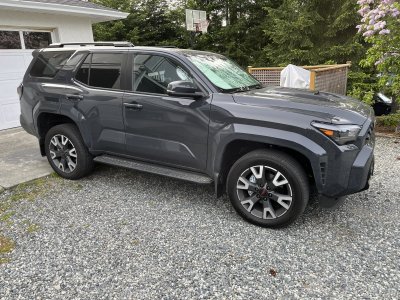

Hello,
Let me start that we are super happy with our TRD Sport, yet coming from a BMW am super confused with the endless alerts, auto braking for no reason, siren going off in Starbucks drive thru, and “cruise control not available see manual”.
Being new, was hoping that one of you may have found the fuse that can be pulled to stop all that drama that takes away from a great truck? Or any “do this, disable that” instructions for any new 6g4r member?
my 4th 4Runner, and still like the simplicity of the 1997 4Runner, that my ex still drives as daily driver!
Hope there is some smart folks out here there?
J.

Nice! Let me go thru that link. Siren was when parking in a spot that had a soft leaf shrub, guess Toyota engineers configured that as a head on collision…? KISS
