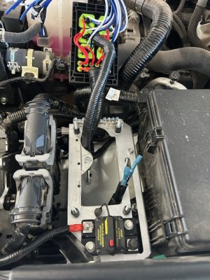

Installing the tray
I took the tray down to size and cut out a square (as much as i could without removing a mounting point) on the bottomot open up the bottom fro the relay box. I'm not installing onboard air, so I utilized the open space on the drivers side between the existing fusbox and the CPU. There are two threaded holes existing and a bolt on the fender side of the engine bay. I used threaded rod and couplers for support struts. I also installed a 30 Amp circuit breaker. I don't plan on running more than lights, so 30 Amps is plenty.
Prepping the Relay Box
The relays are bosch style 5 pin, so the yellow wires are all the normally closed power outputs. I'm not running anything but normally open switching, so I clipped off all those leads as close to the silicone base as possible and sealed them up with some black silicone RTV. I wasn't crazy about the six red common leads on the output side power supply and the six black ground wires on control (switch) side of the relay, so I step spliced both into longer 10 gauge wire with terminals to the breaker and the grounding lug. The long leads give the relay box to allow easy dismount for future wiring.
