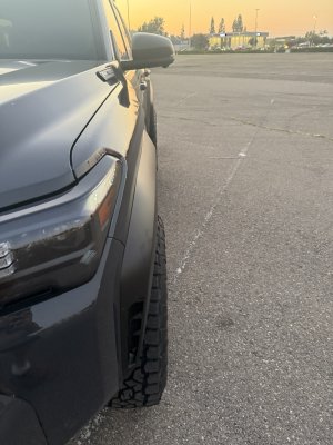

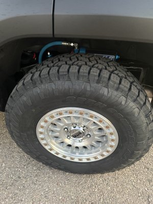

Just picked this up last week and here we go. Kings all around with Kmc’s wrapped on ~34’s. Running no spacer or aftermarket springs in the rear. Went 2 1/4” on the King’s and I’m happy with how she’s sitting. NO RUBBING!!! Mpg’s before install were around 22.5.. I’ll update how we’re looking after. Overall nothing crazy. Simple.
Specs:
King 2.5 coilovers w/ reservoirs
(25001-415A-416A)
Kmc 17x8.5 +25
(KM552) (KM552SD17856825)
Icon tubular upper control arms
(58452DJ)
Toyo open country at3
(285/75r17)
Tint
(50% windshield 20% all around)
