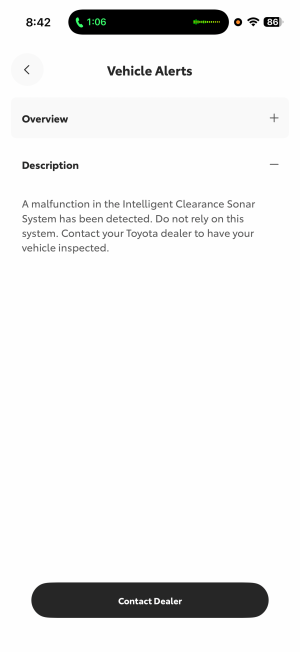

Leveled my 2025 Trd sport in my driveway following the instructions included with Toytec leveling kit. Called for loosening the lower control arm bolts and it threw my alignment way off. Front it 100yrds and it started throwing all kinds of codes for lane assist, hill descent, pre collision etc. brought it to Toyota they say they don’t know what’s wrong with it and it will take 4hrs of diagnostic to start with on the laser rack to see if they can figure it out. Is this not a common mod? Did I do something horribly wrong? Anyone else have any tips on what I should do to have this diagnosed or should I just hand Toyota a blank check?

Copy that, you mentioned.... throwing all kinds of codes for lane assist... was just curious to see what the DTCs said.
