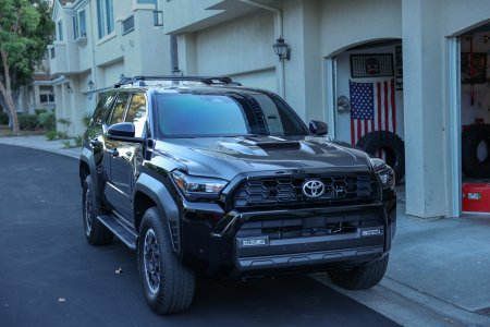

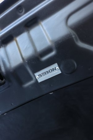

Here it is! The carbon fiber hood for the 6th gen! 🏆 This thing is super lightweight, fits perfectly with zero gaps, and even uses the stock hardware just remove 4 bolts and you’re good to go.
One thing to note: it doesn’t have a spot for the factory hood prop, so I highly recommend upgrading to hood struts for a cleaner setup.

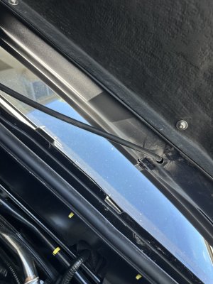

As for the windshield sprayers.. there is a spot to click them back in but you need to drill a little hole under them to stick the hose through… took all of 5 mins 👊🏻

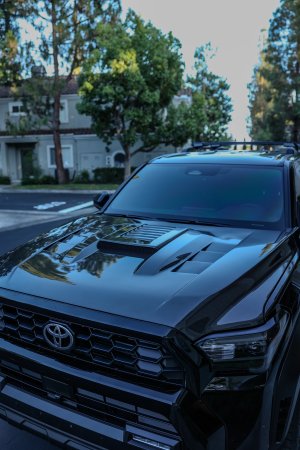

Big question…Is it functional?
✅ Yes, it is! The center insert underneath can be removed to make it a fully functional hood scoop. That middle piece actually doubles as a rain catch, so you’ll want to pop it back in when it’s wet out.
Other than that, this thing is sweet! Loving how it looks and feels. 👌
