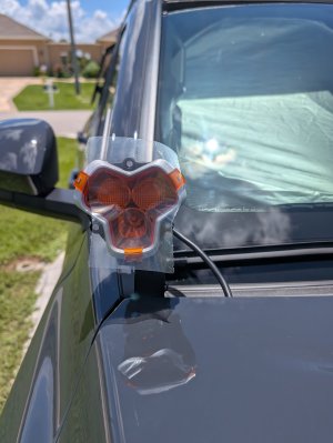

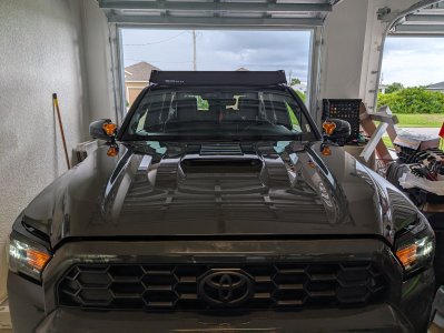

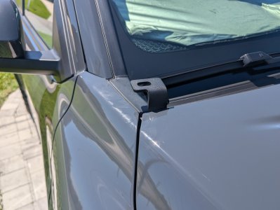

Installed CBI ditch brackets. Pretty easy and quick. Did 1 bolt at a time starting with bolt farthest from windshield. Then installed Novsight Halo 3" Pods. I used a fuse tap and put in the radio spot in fuse box next to the battery. Definitely not the correct place but I can make them work. See it in action here (video). Been waiting for a Garmin Power Switch from Blaze (10 weeks already Blaze!! Grrrrg). No idea how you guys do clean wiring everything is so tight in there. I did use some metal clips that can slide onto edges that you can pop the wire on (and there is a LOT of harness wire LOL). Watch the video link it's pretty cool IMHO.

Those lights are pretty wild. That sequence is next level. How's the quality feel on those?
They feel pretty beefy and heavy to me (granted I have nothing to compare against). It came packaged in really nice packaging and seems pretty premium. Their Support responded in less than 24 hours, so that is a bonus.
I want to get these ditch brackets, but I also want the red line hood props. I wonder if it’ll interfere
I think this is the configuration @TRD JON has so he may be able to answer that. Those bolts didn't seem that long when I put the brackets on.
