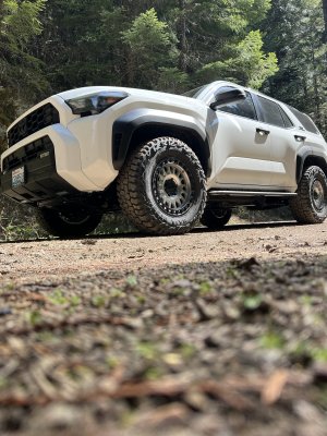

275 70 18
Nothing done to suspension at this point
+30 offset
Stayed with 18” wheels
Have not trimmed or removed anything
No rubbing
