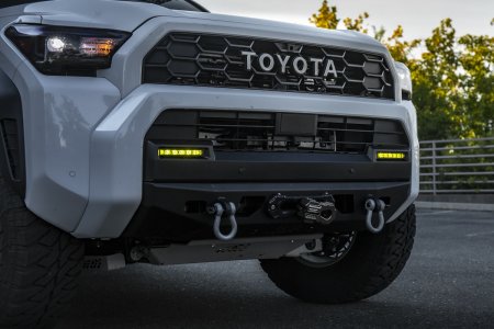

Finally got the Cali Raised LED fog light replacement kit. Pretty affordable set of amber light bars that ship with everything you need to install them out of the box. You get the light bars, plug-and-play pig tails, brackets, and all the hardware. They are 7000 lumens, and about 3000 kelvin.

Here are some other shots of the lights. Will get them installed soon. I didn’t realize how ugly the OEM fog lights were until I put these light bars up against them. lol

OEM FOG LIGHTS​
CALI RAISED - AMBER Output​
Installation was pretty easy, all things considered. Taking off the front clip is simple but it’s the disconnecting of the plastics on the actual bumper that can be a pain. Installing fog lights is easy but I also installed a TRD PRO GRILLE at the same time and that was a pretty involved process.
Once you have the bumper off, all you have to do for the fog lights is remove the shroud cover that sits in front of the fogs. Once you remove the cover, you will uncover two screws that need to be removed. Once those screws are off, you can swap in your new fog lights.
Looks awesome! How long did it take you to install?
Install for just the fog lights is not bad at all. Once you have the front bumper off, all you have to do is remove the shroud and then the fog lights are a direct swap. Then you snap the cover back on and you're done.
I would say all in for the fog lights alone, it can be done in under an hour.
I was also installing the TRD PRO Grille from @kophoto4x4 and that's what took me half the day. Turned out great though. Pretty stoked on the front end.
